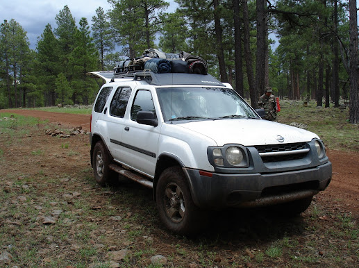

In the summer of 06 I bought my Xterra from Power Nissan.  I had always liked the way they looked and decided to take the plunge.  It was my first car.
This is what she looked like when I bought her and shortly after.

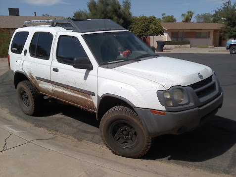

When we SASed my brother's 4runner and I took the wheels and tires (31'' ATs).
I set out to find the parts.  I will say that the hardest part of this entire process is getting the parts.  Simply put, there really no Xterras or Frontiers in boneyards.  Over a period of a few months I picked up the parts needed to do the conversion.  The end result is this:
In this thread I will go over the details of how I did this in case anyone (as crazy as me) wants to do this or is just curious if it can be done.  Thanks for welcoming me to the forum and the club!
