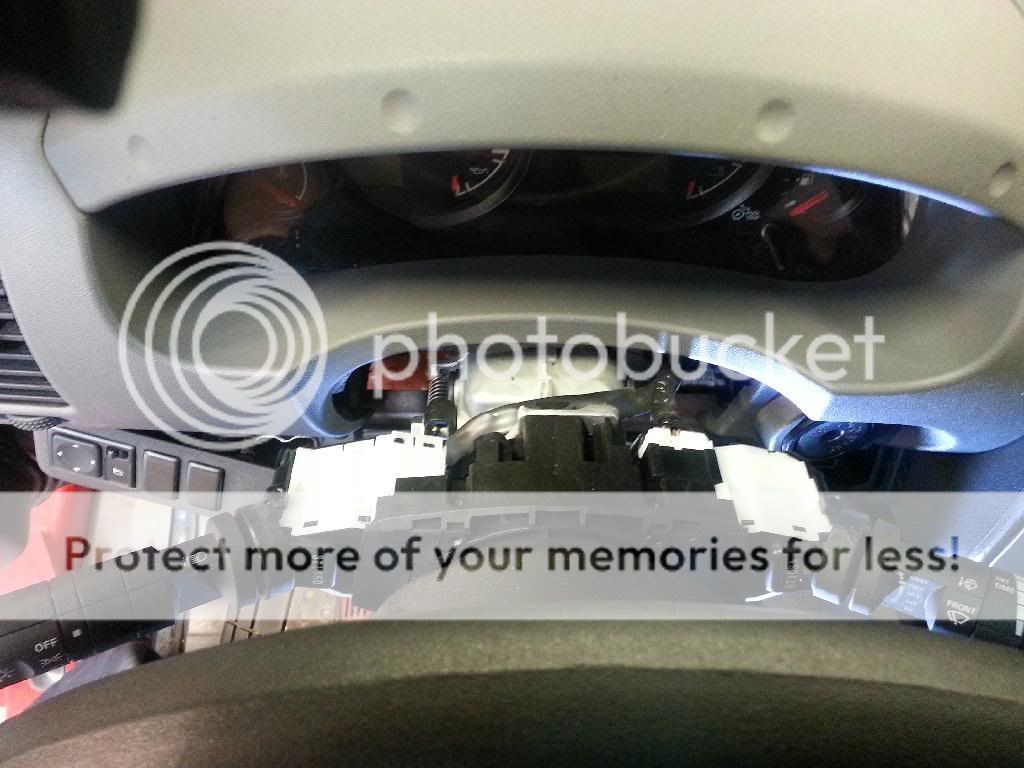

Once the three screws are removed then separate the upper and lower halves of the steering column cover. Just pull it apart at the seam on both sides of the steering column. remove both halves and set aside. It will look like this.

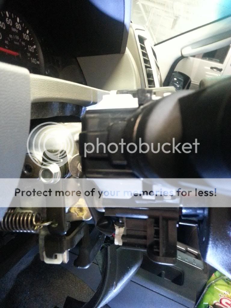

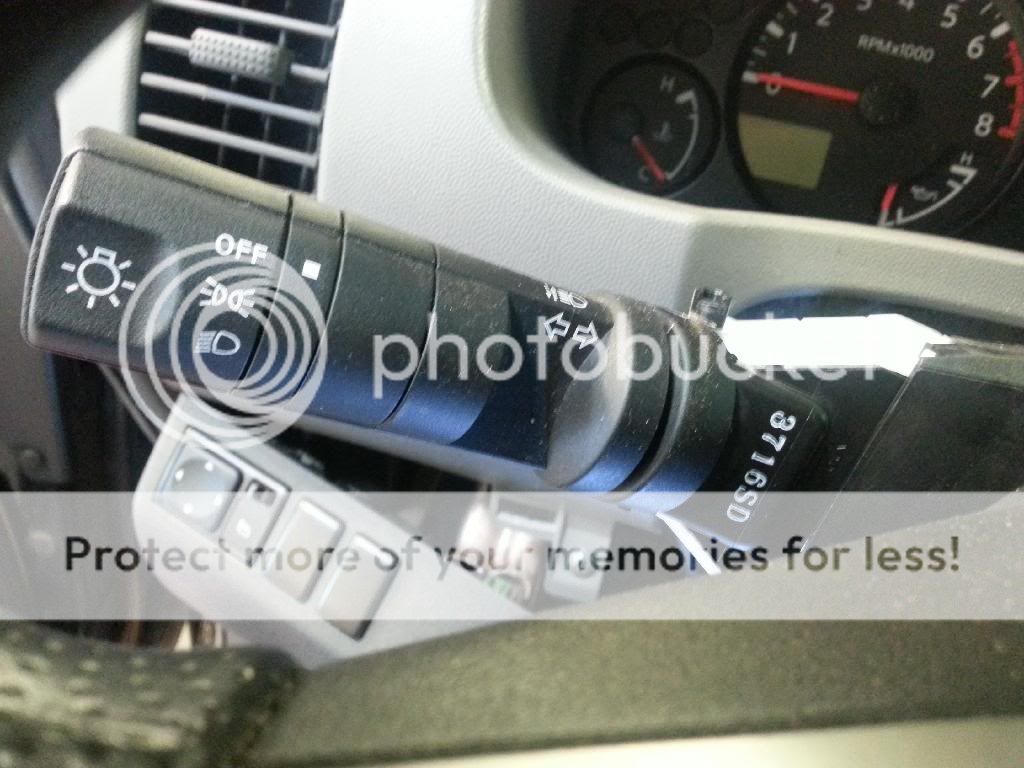

The turn signal switch is the stalk on the left.

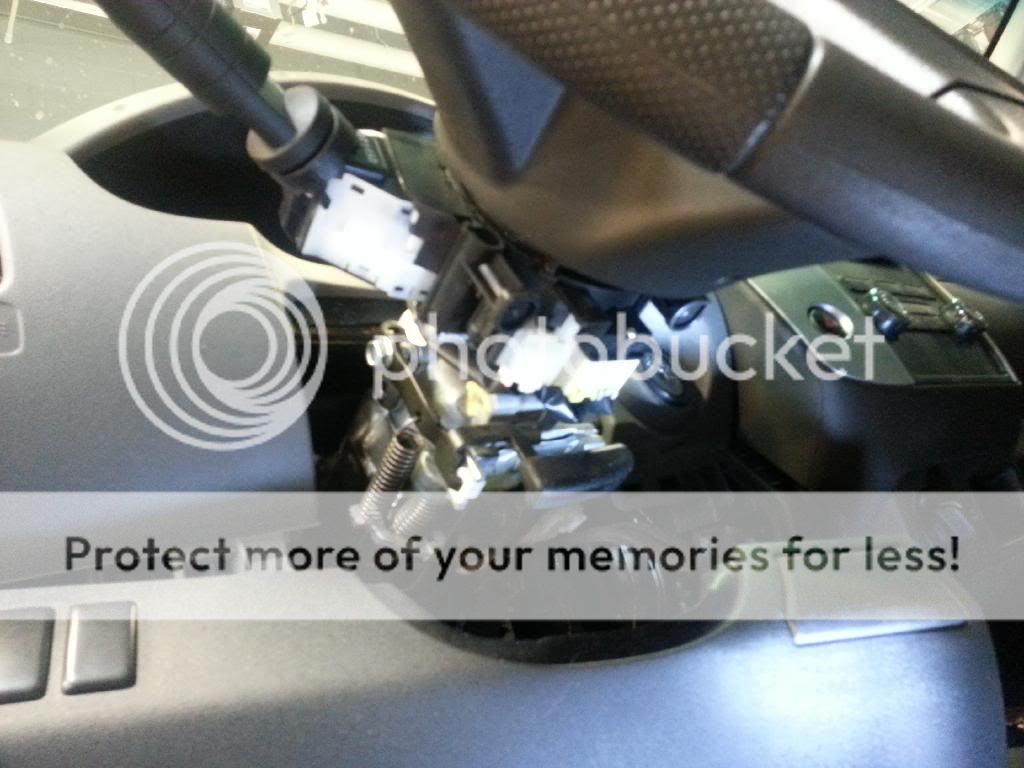

There are two white tabs that need to be pressed to remove the switch. One is on top and one is on bottom. Press both white tabs and pull the whole switch out towards the drivers door.

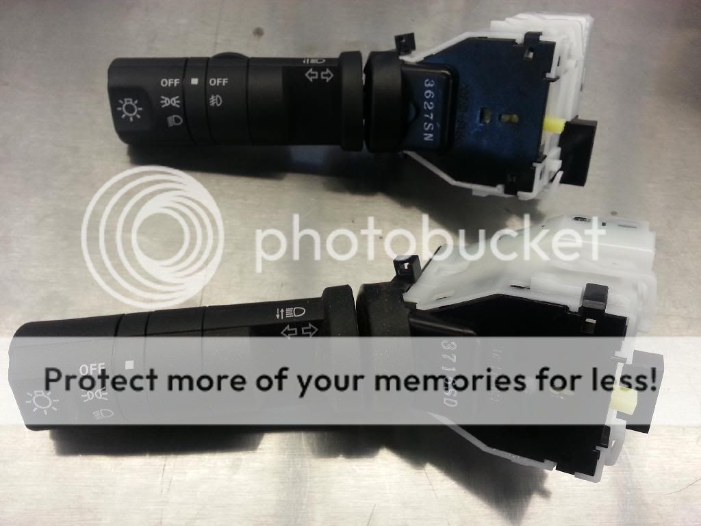

Turn signal switch with and with out fog lamps. With fog lamps is the one that I will be installing.
Slide the new switch into place. You will hear it snap in when it is seated into place.
