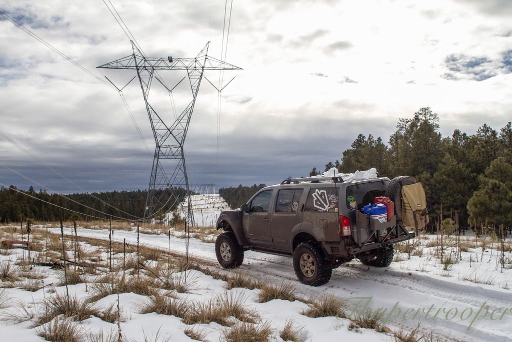

2005 R51 Pathfinder OFF ROAD Edition
2018 UPDATE
Suspension
  Front
- Extended travel 2.0 Radflos with 3" spacer
- Heimed tubed UCA 7" wider that clears the coilbucket
- Boxed LCA 7" wider over stock
- Heimed outer tierod end
  Back
- 5125 Bilsteins Valved for a VW buggy
- Rear Armada HD springs
- Airlift 1000
- Custom drop bracket lift 4"
-Titan Front brake lines in the rear
  Drivetrain
- 315/75/16 285/75/16 Bfg KM2s
- 6x4.5 to 6x5.5 wheel adapters
-16x8 offbrand fake beadlock wheels
- Volant CAI with pre filter
- R180 Lokka
- Custom 4340 RCV axle shafts with stock CVs
  Exterior
- Custom made flush rocksliders
- 40" Tuff Stuff LED Light bar spot no flood
- dual oval LED amber spotlights (Amazon)
- Custom rear bumper with dual swing outs(gascan,tire carrier)
- Duraflex 3.5" bulge fenders
-FreeSpirit Recreation Small Canopy RTT Green
-FreeSpirit Recreation Large Awning
  Interior
- Midland 1001LWX with 3' Firestik and 6' Firestik( depending on clearance)
-Kenwood TM-281 2M radio with 3' Firestik
-1 12" RF T2 with 2 RF 400W bridged
Coming Soon
- Start gathering material for front winch bumper
- Install 20.1" Amber LED light bar
- Build drop in basket for roof rack
- Re work camber bolt adjuster for the front
- Keep working on HAM license
- Find new shocks for the rear, better valving same length
- Build a rear cargo organizer that i can bolt down
4/18
IMG_0847 by Victor Lopez, on Flickr
